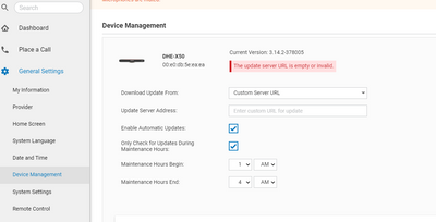

I used the Custom server URL option:
You can find the URL at: update.polydemo.com - Search for G7500
If the endpoint to have internet acces, then you can download the firmware and downgrade the Poly X to Poly OS 3.3.2, Update TC8.
In my experience I have 100% success going from 3.3.2 to 3.7.1 to 3.14.2 - Remember to make sure the TC8 is update during the update path.
