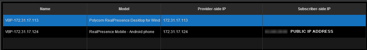

I´m having some issues with presence and XMPP registration at RMD & RPM clients, there is 2 pictures attached, the first one is the real presence desktop, ant the second one is the reverse proxy configuration at the RPAD, some suggestion?
thanks ...!!
It was solved deleting and adding a new entry of Video Border Proxy, at the Resource Manager--> Network Device.
The issue was solved.
Image attached.
Image attached.
Just had the same issue, thanks for posting the solution!
