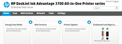

Bought it 2 days ago, when setting up I changed the Admin Password, now everything is locked on EWS, I tried Network Defaults from the printer but it did not reset Password, I need to do a Restore Factory Default, of course I called Tech Support and I got the run around with Network reseting again and again although I told them I did it more than once and it does not work.
I need how to Restore Factory Defaults from the Printer itself physically from the buttons.
Thank you for your help, the only thing I did was change the Admin Password when I was setting up software through USB. I tried your solution, but it did not work, I tried several times.
