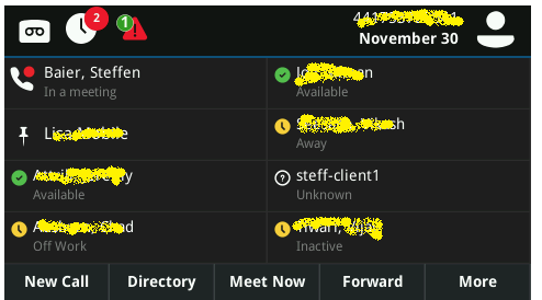

Enhanced Feature Keys Enhancements:
  • Polycom UC Software 5.7.0 allows you to assign an Enhanced Feature Key as a line key using feature.EFKLineKey.enabled parameter.
    After you enable this feature, all the EFK macros that are configured using efk.eklistparameter having efk.efklist.x.status=1, display as a line key.
    Before you enable this feature using feature.EFKLineKey.enabled, make sure the value of the parameter feature.enhancedFeatureKeys.enabled is set to 1.
    The Icon for this is the Pin
<test 	feature.EFKLineKey.enabled="1" efk.efklist.1.action.string="ReplaceWithNumber"
		efk.efklist.1.mname="ReplaceWithName" feature.enhancedFeatureKeys.enabled="1"
		efk.efklist.1.status="1" />
The above would add a phone number with a name
More details >here<

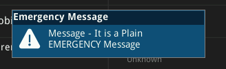

SIP emergency message:
VVX business media phones can receive SIP emergency instant text messages. You can configure audio alerts for incoming instant messages and set the duration of time that emergency messages display.
Configure emergency instant messages using the following parameters:
  • feature.instantMessaging.displayTimeout
  • feature.instantMessaging.ring
  • feature.instantMessaging.enabled
The feature expects a SIP Message with Priority: emergency

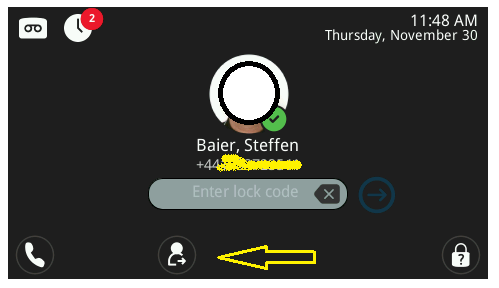

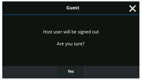

Hot Desking
Polycom UC Software allow users to sign-in on to the host phone or a common area phone as a guest user using Hot-Desking feature. When this feature is configured on the Skype for Business server and configuration parameter is enabled, a Guest soft key displays on the phone user interface. The guest user can sign-in to the host phone by pressing the Guest soft key followed by one of the signin methods:
  • User ID
  • Pin Authentication
  • Via PC
  • Online Web Sign-In
The following parameter configures host desking:
  • feature.HotDesking.enabled
Once the User is signed out you are presented with the sign in screen
