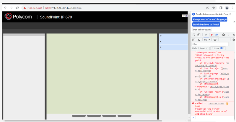

We used to have this on SoundPoints/SoundStation case 32416441 / VOICE-68404 based on different language in browsers

"Seems this browser issue is known to Poly, and we already found the workaround...
We have been receiving reports from customer with the same issue, when using the latest version from the MS Edge browser (110.0.1587.xx) (I also have the same issue on my Edge with this version when I try to access my Trio 8800, but when I use Chrome it is fine)
Please ask him if it is possible to use Firefox browser, or Chrome (on version 110.0.5481.100, because the previous version had the same issue).
It is related to the browser and changes on java script components."
