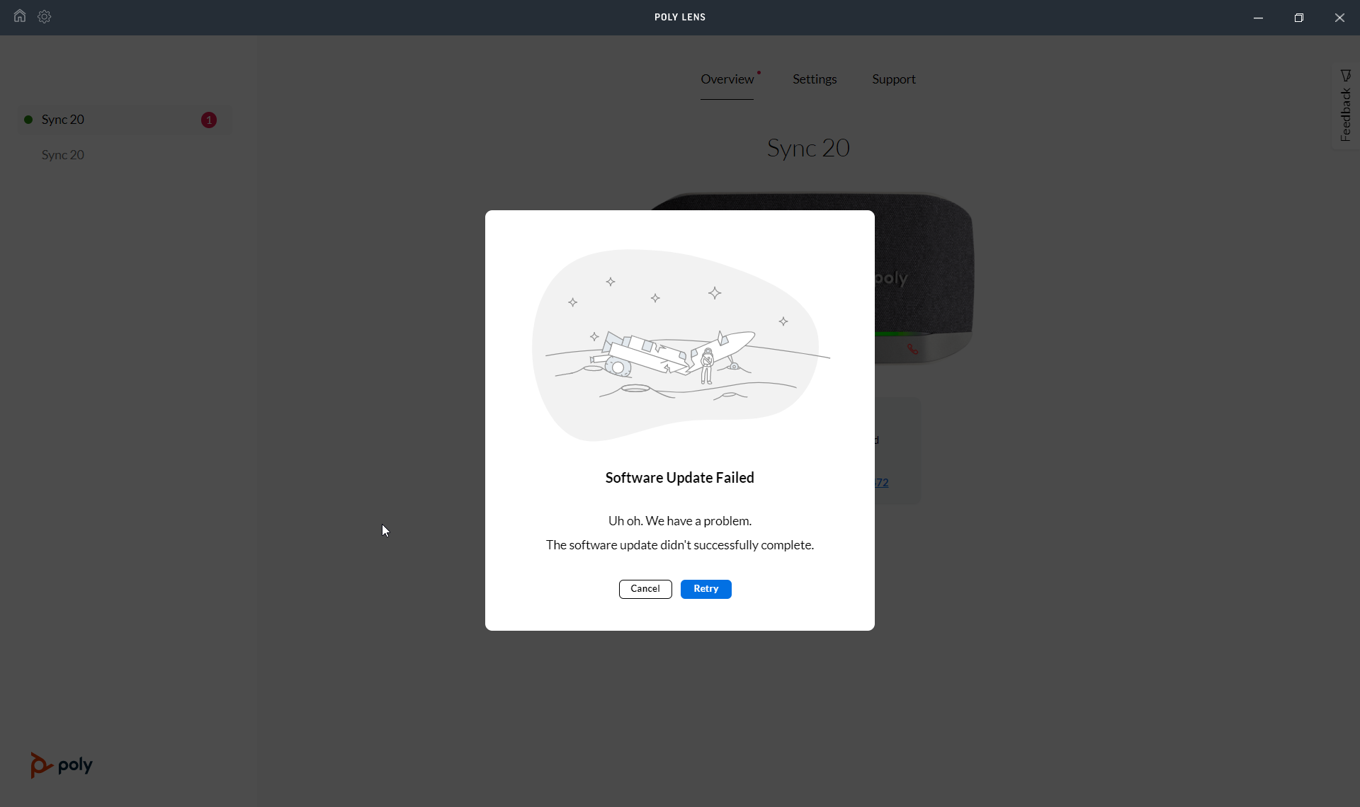

I have recently bought a Poly Sync 20 USB-C with BT Dongle. Since I installed the Poly Lens software to try and update the Sync 20 device it has failed every time. I have attached some screenshots of the error message and the event viewer error message. I also downloaded the logs but didn't want to attach here just in case there is sensitive information in there.
Device Model
Sync 20
Serial Number
S/NEE645C
Software Version
122
Product ID
0x015C
Let me know what else you might need to assist.

Hello, same problem for me in France...
Bye a Poly Sync 20...
When connected tio Poly Lens, an update is annouced.
I tried to update, software download seems to be ok.
But update is very slow an stop at 50%..;
Hi John,
I had the same unit and got the exact same problem.
I found a workaround by updating the Sync 20 with "Plantronics Hub Desktop" instead of Poly Lens.
Link for software:
https://www.poly.com/ca/en/support/downloads-apps/hub-desktop
Let me know if this works out.
Cheers!
