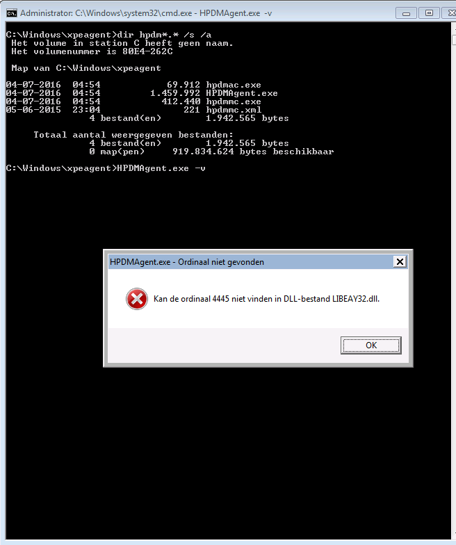

Whats's the exact commandline for the SC command? it does need parameters.
Or you can simply go to the Agent folder c:\windows\xpeagent
1. hpdmagent.exe -v to check the version and capture the error message if there is any.
If there is no error from above step, try
hpdmagent.exe -i to reinstall the service, again to capture the error message if there is any.
I am an HPI Employee.
My opinions are my own, and do not express those of HPI.
**Click the White Thumbs Up Button on the right to say Thanks**
After running hpdmagent -v I'm indeed getting a LIBEAY32.dll error:
Could not find ordinal 4445 in DLL-file LIBEAY32.dll (translated from Dutch).
