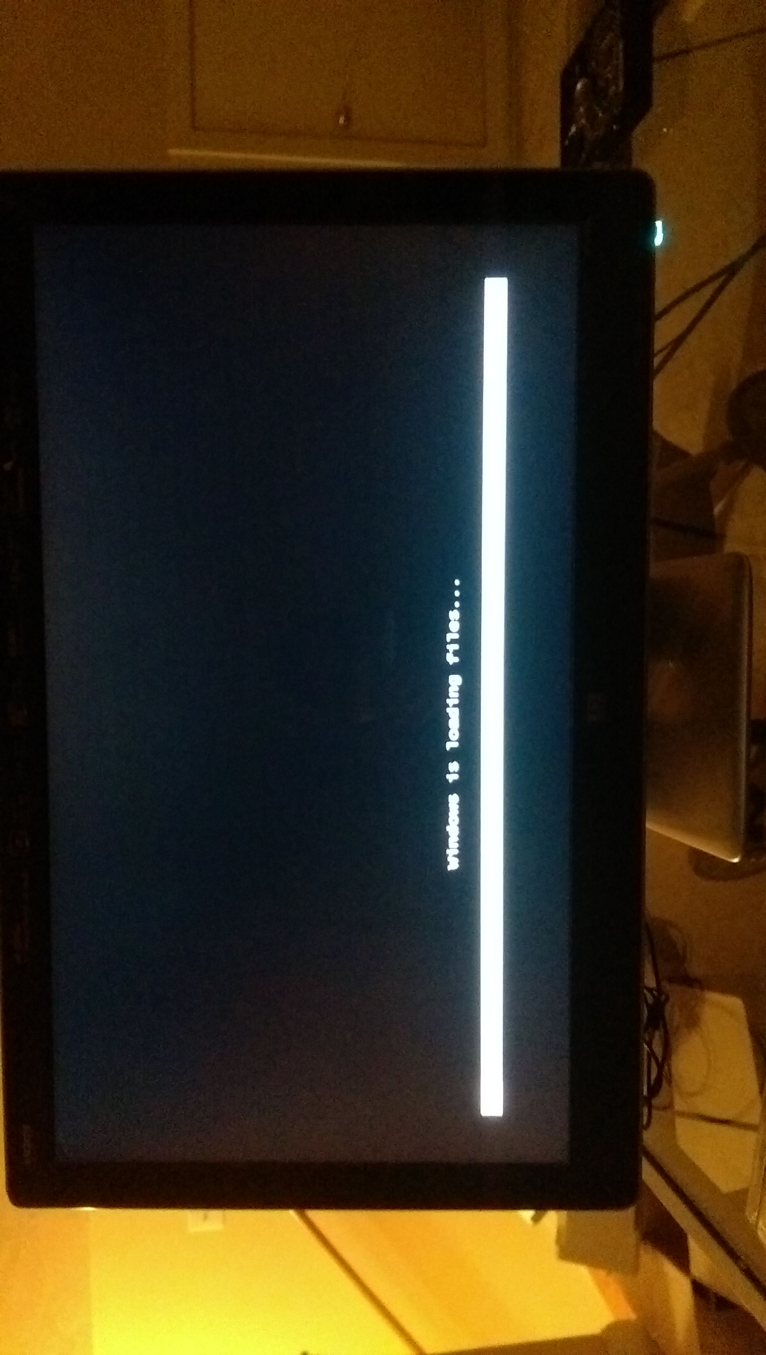

My desktop came with win 7 home premium installed, and was running great. Last week suddenly could not start after updates, saying "BOOTMGR is missing Ctrl+Alt+Del to restart". The first thing I did is to repair windows and could not. I decided to go ahead and install windows 7 from scratch. I wiped all HDD, and create new partitions (so I will have three in total, 100MB, 500GB, 480GB - I have 1TB Hitachi Drive HDT721010SLA360. )  I hit continue and finished copying all files. It got to extend win files and stuck at 6% - after a while got a blue screen and windows install loop begins. I try again, and stuck and windows install startups. Tried more and more, at various stages including BIOS first screen, windows load files, windows starting - computer stucks... sometime just infinte loops, and loops.

It does not let me go that far. It stops at "Starting Windows and loop begins"

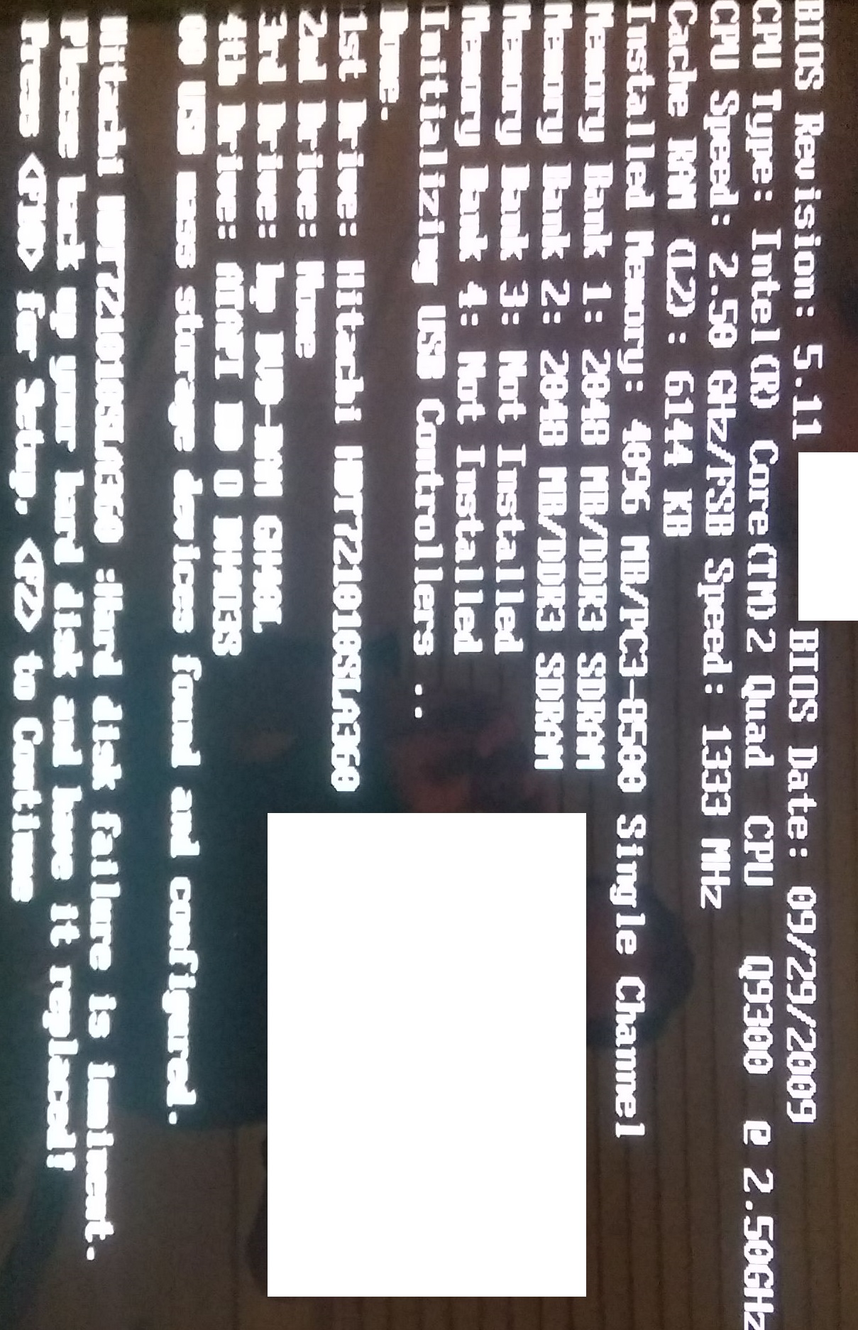

The test I was refering to is HP diagnostics. When you start computer and select F9. The one you asked me to perform earlier.
The last black screen shows at the end that HDD failure is imminent, please back up your data.
