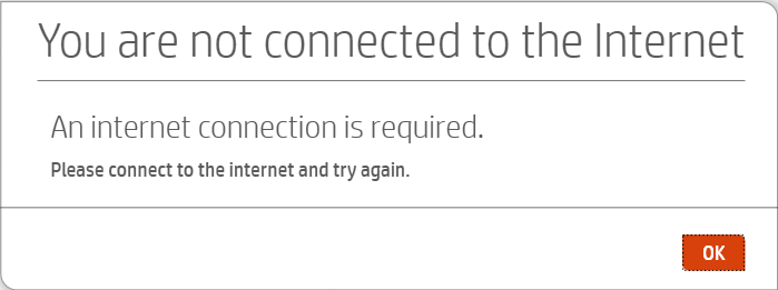

Hello,
I upgraded the "HP Support Assistant". It is successfully installed, but upon clicking "check for updates and messages", it gives a message that I am not connected to the internet although I am connected...
Any help is appreciated.
Thank you.

I get the same error under the same condition. The strange thing is that the HP Network check says I'm connected to the internet.
To note that on the same local network, on a Windows 7 pro 64 bit laptop, the same version of HP Support Assistant has no problems.
As a followup: I had my previous problem when I upgraded from Winddows 8.1 to Windows 10. I recently performed a clean install of Windows 10 on the same computer. Now HP Support Assistant finds an intrnet connection.
Had same problem.  I found out that I had installed Hyper-V and set a virtual network adapter that was preventing support assistant from connecting.  After removing the Hyper-V adapter - support assistant worked fine.  Just something to try.  Hope this helps.

True. I removed the "External Virtual Switch" and HP Support Assistant worked fine.
After recreating the "External Virtual Switch", HP Support Assistant it stopped connecting to the internet...

I just installed the latest version, 8.1.52.1, as of 2/17/2016. The same problem still exists. I couldn't just disable the virtual network interfaces. I really don't want to actually remove them just to check for updates.

Just got this today too! Reading through previous posts I am guessing it is to do with Hyper-V as I have Hyper-V installed too.

Found the fix.....  Hope it works for you.
Incorrect bridge setup in windows networking was the underlying issue.
(Thanks to a prior post here I remembered something strange about how I had bridged the adapters years ago after adding vEtherenet to get wifi.)
Step #1 (while you still have internet)
Update to the latest support assistant here: http://www8.hp.com/us/en/campaigns/hpsupportassistant/hpsupport.html?jumpid=va_r602_us/en/any/psg/pl...
Install & reboot.
Step #2
Remove all network bridges. (loose internet)
Recreate network bridge  by selecting/using both WIFI and the stanadard ETHERNET connection.  (and not the vEthernet)
Everything is still enabled, I still have vEthernet setup but no bridge to it.  Prior to this, the internet worked OK over wifi with the occasiona (2x a wee?) necessity to "reset adapter" needed to establish web connection.  Maybe this fixes that issue too?  Time will tell....
Now all is well with the HP Support assistant version 8.3.34.7
(Before fixing, the HP internet diagnostics tool was still finding the internet and indicating there were no problems, but the update part of the app was not connecting to servers.)
