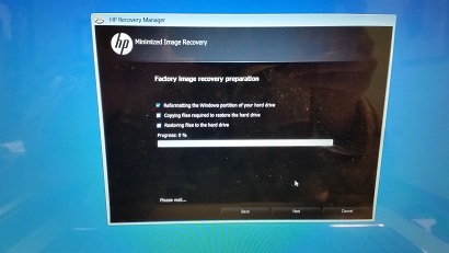

Forogt to put more details about my specific computer:
HP Envy Touchsmart 17
Model: m7-j020dx
Product: E4S19UA#ABA
I have been attempting to restore/recover using the factory recovery image on the HDD.
I have attempted now 3 times. The last time I tried using the information about reseting the date in the BIOS and rechecking at the first reboot.
Here is a photo log of the process. Please advise if I am doing something wrong.
02-13-2015 01:26 PM
Indeed, amen to that War_eagle,
Hey, I'm what they call around here a noobie not an expert but after dozens of failed attempts ending with that same log file screen. No answers as to why from tech support so did some reading here on this forum digging for a solution then finally had success I wanted to share and help, I feel for you n looks like your doing as it is supposed to go.
One thing ypu might try is doing a hard reset... unplug the power, pull the battery and press n hold the power button for 20-30 seconds. Put battery back, plug in and restart, go into bios again and use the (setup defaults F9 I think) save and restart, go to bios again to change the date or make sure its back to before your (born on date) is the day you first powered up your computer and should be listed a couple lines below the system date if your bios shows that like mine does. Mine was 12/29/2013 so I changed the current system year date to 2012. Re-run the factory restore.
I had done at least 3 bios updates by the the time I began having issues and needed to restore just a month and a half ago.
Thats the only other thing I can recall doing before my last attempt that worked.... give it a go, wish you success
