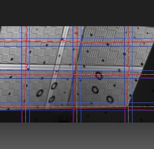

I am trying to calibrate my new DAVID system but I constantly get the error 'Could not detect enough markers of calibration panel' . I have tried adjusting the brightness and the focus and everything but still no look . I have attached a screenshot of the camera from the application

1. Light level seems to be too low, increase projector brightness or exposure
2. Projector pattern seems to be blurry, use lever on the projector to make projection sharp
3. Picture from camera is unsharp, use first ring on camera lens to set everything sharp
4. Try to set camera pointing between calibration panels under 90 degrees angle or close to that value
From your picture it looks like camera is pointing between calibration panels in 45 degrees
You can take a look at pictures how it should look like.

Sharpening the camera image worked perfectly. Thank you
