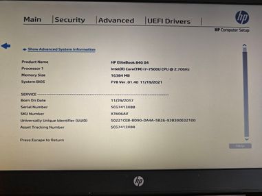

But I have the following error:
"Failed to import Secure Boot custom * from \EFI\HP\*.bin, or the file was not found.
This is my current setup:
What I am doing wrong?
Thanks,
Javier
