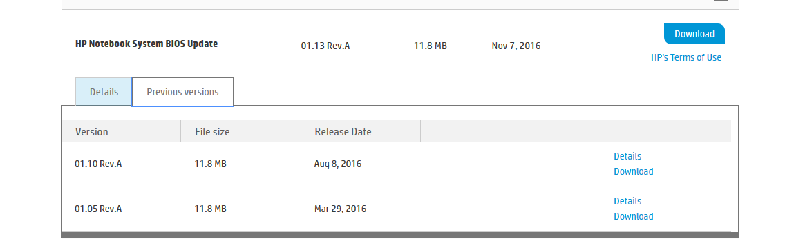

BIOS versions available for your notebook are as seen in the following image.

The current version of the 840 G3 BIOS might not work, so you should also try an older version, when you locate the BIOS download on HP.com there should also be a link below it to download "Previous Versions"
After you download the BIOS Update run it and choose the option "Create Recovery Drive" to make the USB drive you will need, the recovery drive will have the binary file in the Hewlett-Packard\BIOS\Current Directory, copy that file into the Hewlett-Packard\BIOS\New directory for updates. (file copies will be in both directories)
I've been having some issues with the new 840 G3 and 840 G4 updates and have escalated the issue with HP Tech Support, the current workaround is to use the previos BIOS until the issue has been resolved.
