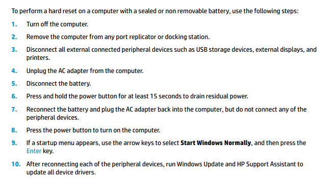

4. Perform hard reset:
Let me know how it goes
