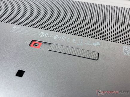

You should run it with the bottom cover off and flip it over so as to see where the sound is actually coming from. Perhaps you need a new fan. ZBooks are powerful machines and they have thermal issues.... Cleaning it out never hurts, sometimes some dust gets caught on a fan and it becomes noisy.

Cleaning the laptop with compressed air after taking the back panel off is routine user maintenance. Like cleaning your car.
Your laptop has two fans as seen in my previous post's picture. One cools your processor and the other for your graphics video adapter.

Now it´s a bit spooky. I have opened the service hatch. The computer is perfectly clean inside, no dust, just to be sure I used some air to blow the few particles away. The sound still remains, and when it sounds, the fans both are still. They´re not moving at all. So it has to be something else. It might not be a device with moving parts, it may be the sound system. I will have a look into the BIOS to see if there are any setting I might try there.
