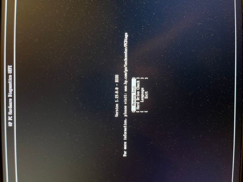

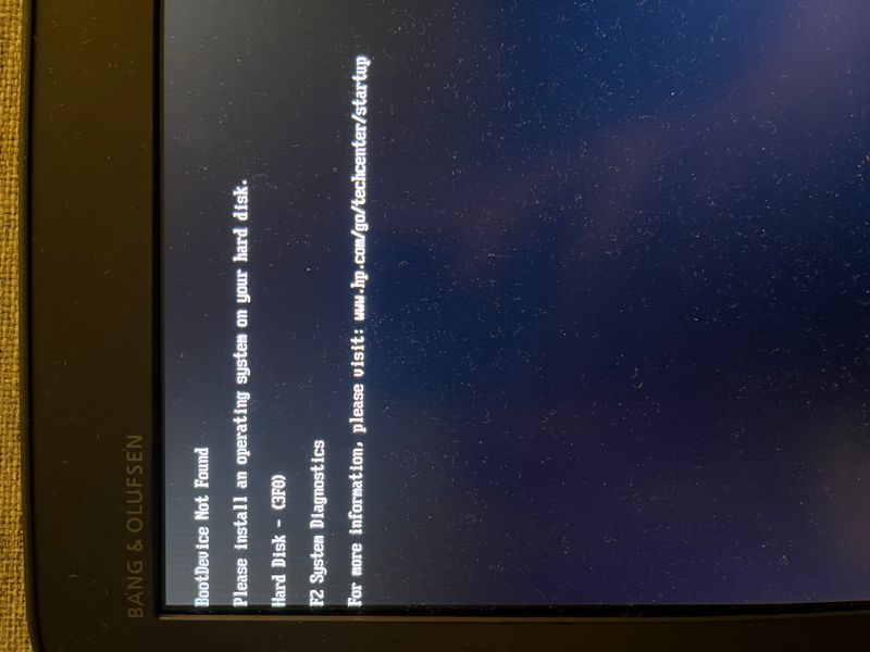

I have a HP ZBook mobile workstation which ran out of power yesterday. After reconnecting the power cord I powered it back on, but Windows just won’t load. It’s stuck on the screen showing HP and won’t get past that.
I googled the subject and found various solutions for what seems to be the same problem, but none of them worked for me (assuming I did it correctly):
  • Hard reset holding down the power button for 2 minutes
  • Booting and entering Windows button + B (or V)
Attaching screenshots of various menus I’m able to access.
Thanks in advance for any help on this. : )
Johannes

It looks like your primary storage drive has produced a fault and needs to be replaced.
If you are not experienced with computer internals, I would recommend taking the laptop to a local (HP) computer service shop for further diagnostics, and a new drive. They can also help in cloning the drive contents to the new drive if the old drive is still working to some degree. The new drive will also need to have Operating System (usually Windows) and all drivers and software you use to be re-installed.
Please include your exact laptop model in your next response if you need more technical help, e.g. "ZBook 15 Fury G9". There have been numerous different ZBook models in the last 10 years, and they all have different hardware and technical manuals.
