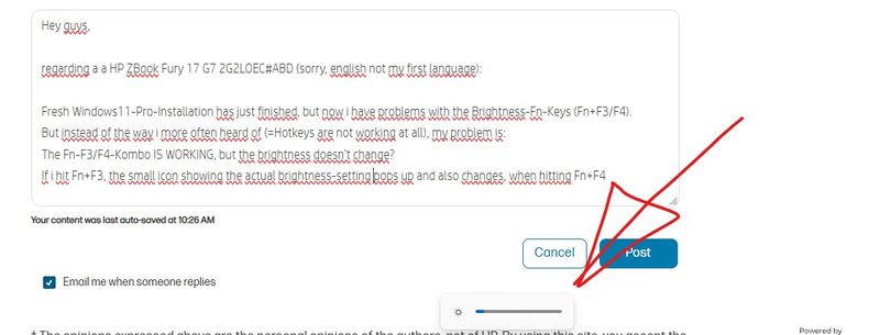

Fresh Windows11-Pro-Installation has just finished, but now i have problems with the Brightness-Fn-Keys (Fn+F3/F4).
But instead of the way i more often heard of (=Hotkeys are not working at all), my problem is:
The Fn-F3/F4-Kombo IS WORKING, but the brightness doesn't change?
If i hit Fn+F3, the small icon (showing the actual brightness-setting, see below) pops up, and i can also change the setting/bar with Fn+F3/F4 without any problems:
But the brightness of the screen is not affected by that? It simply doesn't change?
