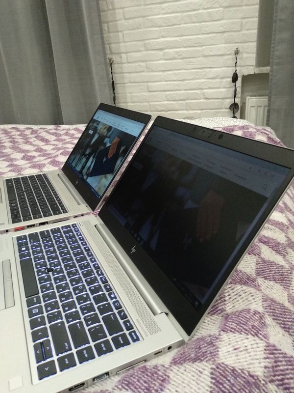

Here are photos to compare to Elitebook 745 G5 to Elitebook 745 G6 . Difference is obvious, G5 looks perfect despite angle is bigger.
SureView is OFF:
SureView is OFFSureView is OFF
SureView is OFF:
Sure View is OFFSure View is OFF
SureView is ON:
SureView is ONSureView is ON
@Pilotg
Thanks for the pictures - they clearly illustrate how HP failed on the newer elitebook G6 models. Viewing angle does not change when turned on or off- it remains narrow at all times. So you basically pay extra to get an ancient screen. Unbelievable how HP even dares to sell this as a premium feature on a laptop in this price range. The fact that it did work well on the G5 models, proves that there is definitely a hardware/software failure, introduced with the newer generation of the sure view screen.
