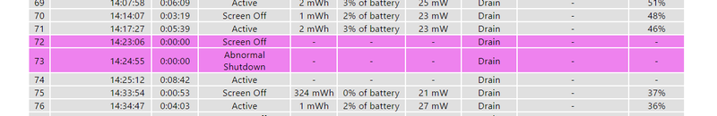

I also performed the sleep diagnostics two times:
While playing music, there is an error about high cpu usage of chrome (which is used to stream the music) and another about realtek driver preventing system from sleep (which I would consider normal as the music would continue playing.
If I run it with no music playing in the background there are no errors.
In both tests there are some warnings related to timer resolution requested by some other software being smaller than default, but apart from increased power consumption I don't think that it can lead to crashes.
When examining the sleep history I noticed that the system at some points goes to hibernate, and is off in the diagram, but there is one time when there is an abnormal shutdown and the battery appears disconnected for a while, which I don't think is normalΣτιγμιότυπο οθόνης 2024-10-20 145807.png

When examining sleep history I notced the entries shown in the screenshot below, where the battery appears disconnected for a while:
