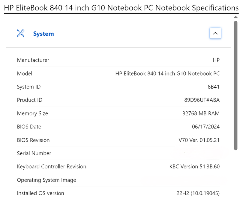

Unable to locate two drivers as shown in image:
Here's the system configuration:
Thanks.

Thank you for this suggestion.  As recommended, I uninstalled the drivers for Bluetooth and my smartphone and then installed those two patches.  While both Bluetooth and smart phone devices reappeared, unfortunately,there was no improvement in Device Manager.
