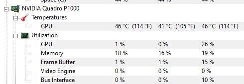

No, my notebook looks like it will fly, but it doesn't cool. After I installed the HP Advisor you indicated, I installed the 391.48 driver, but it still warms up and crashes, but less so. I am installing the driver you indicated now to see if it improves. Thanks, the first tips helped a lot. The temperature without any 3D application  - With 3D app that work (Revit) it goes to 100 degrees.Anotação 2019-12-02 020643.png
