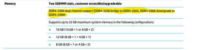

im looking to upgrade the ram of my laptop. Thinking of buying 8gb ddr4 3200 mhz.
but my the manual says that
now i would like to know if i buy the ram https://www.amazon.in/Crucial-3200MHz-2933MHz-2666MHz-CT8G4SFRA32A/dp/B08C4Z69LN/ref=sr_1_3?crid=2BI...
will i get the dual channel support for 3200mhz?????

Hi:
The service manual is for the older model series.
According to the specs, your notebook's processor should run the DDR4-3200 memory at the 3200 MHz speed.
HP Pavilion Gaming Laptop 15-ec1025AX Product Specifications | HP® Customer Support
The older Ryzen 3xxx processors could only run the memory at a max speed of 2400 MHz that is why you see all that 'bridging' info.
