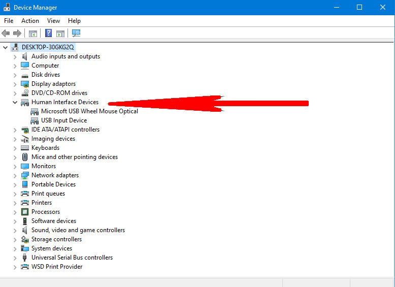

I do not have "biometric devices" between Device manager. I do not know why.
Your sensor may be listed under the "Human Interface Devices" header.
This particular computer doesn't have any such sensors so it's obviously not listed.
If you still can't find it, open each category in the right hand list until you see it in the right hand list but ensure that you uninstall the correct driver!
