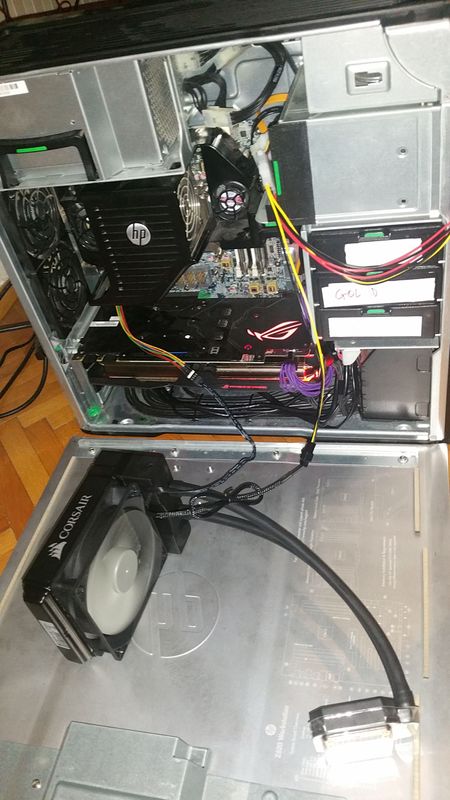

Well, dear gurus, here's the first update 😄
Succesful pre-test of pump and chiller fan powering!
For now I keep a single CPU running in the Z620, so that means:
- rear double-fan connector only feeds the Chiller Fan from the H45.
@Dgroves - thanks for the idea to feed both Sense off the same output from the fan!
(after I upgrade to 2x 2667v2 - now that it's thermally feasible 😄 - I will feed from here the second H45 Radiator Fan)
- I opted for MOLEX powering at constant 12v the pump on the H45... Corsair sais so - I do so.

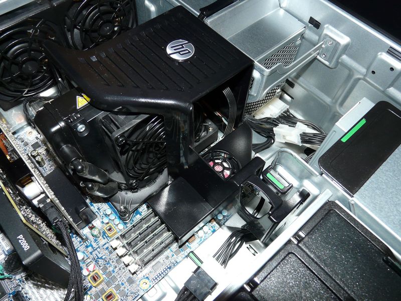

As the z420 and z620 motherboards are so similar an duse the same BIOS, after some research, I decided to try the z420 liquid cooler:
> which simply plugged in about 20 minutes without any modification. This works well: 29-33C at idle and during CPU rendering at 61-64C. As the z420 and z620 use the same BIOS, the z420 cooler is controlled by BIOS and the settings have not been changed from the default. This is impressive as the E5-1680 v2 operates at 4.3Ghz on all 8 cores and it's running well under the 85C maximum rating. An additional attractive features is the small auxiliary fan to cool the chipset. This is the best $50 I've ever spent on a computer component!
