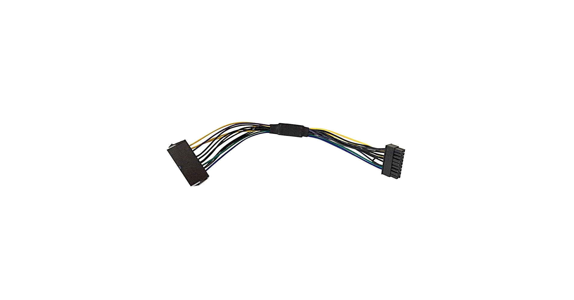

I've noticed that the mounting holes for HP's proprietary PSU are not the same as retail PSUs. Nor is the PSU's size. I wonder if anyone ever found an adapter to physically mount a retail PSU in the Z210 case? I already have an adapter to go from the 24-pin connector to the 18-pin header. Thank you.

Btw, I already have a 18 pin to 24 pin adapter for the Z-210's motherboard. Supposed to be specific to the Z-210. But it isn't doing me any good w/o being able to use a retail PSU.

Well, it looks like this was an excersize in futility afterall. DGroves was indeed correct!
I just checked the pin-out for the 18-pin connectors on the Z210 and Z420. They are not wired the same. Maybe not even keyed the same. But thank you all for walking me through this.
