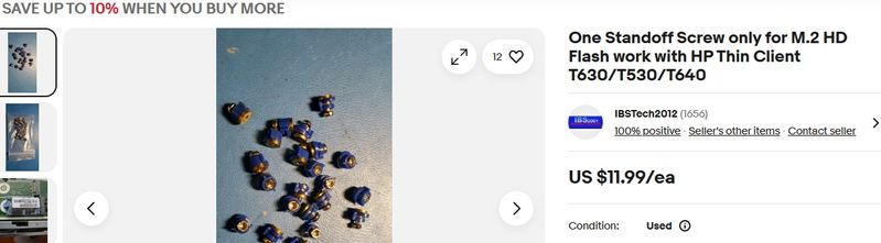

We've been chasing this issue for years now. Per DGroves you want the HP blue plastic/M2.0 thread diameter engineered hold down device. The one with black plastic is M1.6 thread diameter. You can McGuiver a solution assuming the threaded insert is a matching size. See HERE and a guy on eBay has been selling the HP blue plastic ones (M2.0 diameter) ones for about 12.00 USD. His ad is still there.
