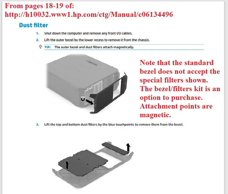

If you'd looked at the options you'd know this existed.  Here it is in the manual, pages 18-19.
http://h10032.www1.hp.com/ctg/Manual/c06134496
It's available as an option when you buy.
It is a 3-piece kit of the upper smaller and the lower larger filter elements plus, most importantly, the whole stock front bezel is replaced by a special different front bezel that magnetically attaches to the case and accepts those two front filter elements perfectly, tightly.
I found it very easily... and it was not that expensive for what I got.
Don't blame HP for you not looking at the options.

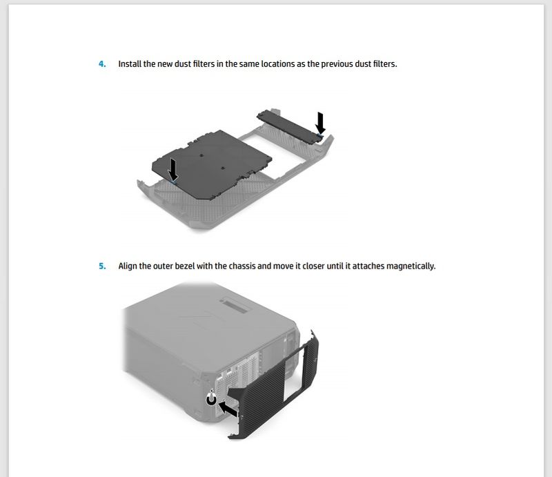

I wish it had been easier for you.  Our discussions should help others, but you are correct.  This kit is not well enough promoted by HP.  I went onto the HP ordering site here in the US just an hour ago.  A number of the Z4 G4 workstations are presented there as pre-made packages.  Others are available in the "build to order" (BTO) format.  In that page if you navigate down to Accessories the bezel/filter kit upgrade is available.  It was listed as a $50.00 option but when I clicked in the box that cost went away and below is what I got... it would be included for free now.  The "memory cooling solution" in that list  is also an item you may want if you don't have it already (option part number 1XM34AA):
I'm sure the BTO approach results in a time lag because the others are boxed up and ready to go.  Here are the two pages from that service guide link I included in my first post above, plus a pic of the memory cooling option:
