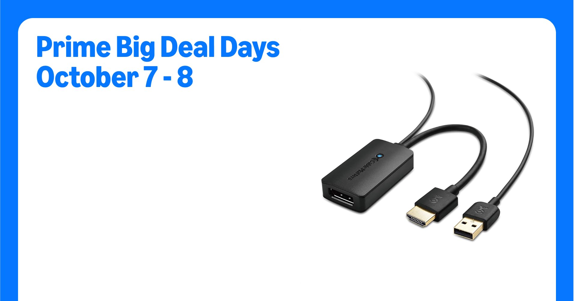

Active HDMI to Displayport adapters are sometimes needed instead of a passive one
and for your case you will need a active HDMI to Displayport adapter
HDMI to displayport adapters have limits on the bandwidth not all have the same specs
higher quality ones support newer standards = higher resolutions/refresh rates
 for your HP monitor you need a "ACTIVE" adapter that can do 1920 x 1080
keep in mind that  the displayport cable should no more than 10ft for best pict quality
here's a active one that should work for you
Cable Matters HDMI to DisplayPort Adapter (HDMI to DP Adapter) with 4K Video Resolution Support
https://www.amazon.com/Cable-Matters-DisplayPort-Adapter-Resolution/dp/B00JQORLCG
