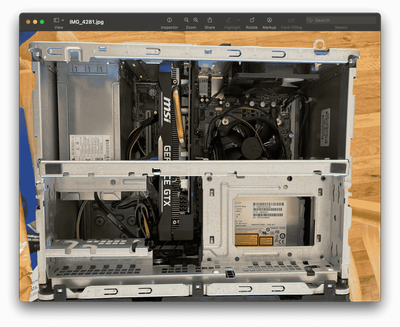

To stay in budget I ended up sticking with a that GTX 1660 model mentioned prior. Found one for $60 on FB Marketplace and felt it was too much of a steal to pass up. After slotting the GPU in into the motherboard and attempting to put the hard drive/dvd carriage back into the device I found that unfortunately the carriage both blocks the 8 pin and does not sit flush. I am planning to either A) take the carriage out the of machine, or B) modding the carriage to allow the GTX 1660 adequate space. I will keep you posted!

Looks like you'll have to do some "modding".  You can either take out the drives cage altogether and then using double-sided sticky tape and/or zip ties to secure any SATA drive(s) you got, or you'll have to cut out/pry lose a section of the drives cage to make the graphics card fit.  If you plan to do the latter, please be careful not to hurt yourself.
The HP ProDesk 600 G3 and G4 MT were upgrade projects of mine, and I applied a fair amount of modding myself, such as seen on page 4: https://h30434.www3.hp.com/t5/Desktop-Hardware-and-Upgrade-Questions/Upgrading-HP-ProDesk-600-G3-MT/....

With the help of my roomate, some elbow grease, and a dremel I was able to mod the drive cage. It now provides the GTX 1660 adequate room and sits flush. I've included some pictures below. I'm now waiting on the PSU to finish this build. I'm a little worried there might not be enought room between the side panel and the 8 pin port for the connector, but will tackle that later should it become an issue.

@captn_calves007,
Outstanding -well done!
One suggestion: I would recommend using a flexible PCIe 8-pin power connector, such as this purchase option: Amazon.com: SinLoon 8-Pin Extension Cord PCIE 8 Pin Female to Right Angle Male PCIE Express Power Ad....
Probably the "right" style option, but you'll have to ascertain that.
