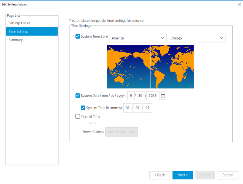

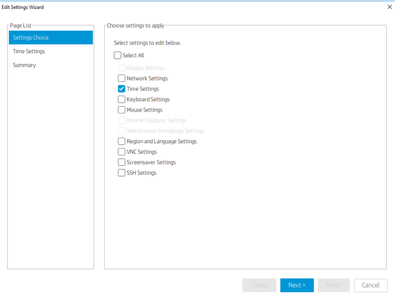

Here is what we did as a workaround for my organization. We created a settings template that sets the time to sept 30 (looks like whatever cert HP uses for Xar extracts expired on October 2nd). We then added this template as the 1st step in sequence to our production template, before the Xar files are pushed. Works successfully. Hope this helps others until we get a true fix from HP. Also the last step in our production template does some profile edits and points it back towards our internal ntp server.time1.pngtime2.pngtime3.png

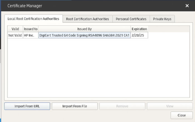

On baseline image (T8X80029-SP10.1) I noticed the following certificate expired 2/20/25
hptc-cert-mgr

This certificate not system, and installed by your HPDM may be.
I just ruled that out by installing a fresh image 8.1 SP 6 from Thin Update using a bootable USB drive to a T630 thin client. I still got the certificate error. I reverted the date to 10/1/25 and I didn't have a problem installing any updates from Easy Update. I'm hoping HP makes the fix public very soon.
