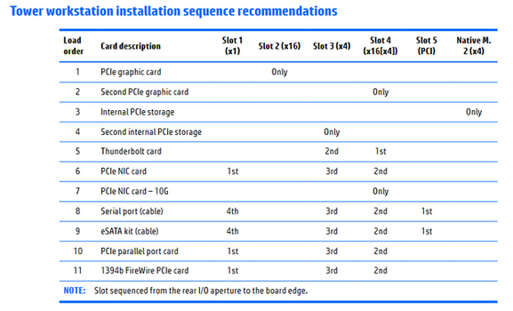

  1. Can I connect a "PCIe x8" SAS HBA controller card in the available Slot#4-PCIe x16[x4]? I am confused because if I take the HP installation sequence recommendations literally (see image below or link here), I am supposed to install internal PCIe storage in the Native M.2 PCIe slot or in Slot#3-PCIe x4 (which wouldn't work?!?).
  2. Can I just connect a "PCIe x4" SAS HBA controller card in the available Slot#3-PCIx4, without installing anything in the Native M.2 Slot?? Again the HP installation recommendations are a bit confusing.
  3. Can I connect a "PCIe x4" SAS HBA controller card in the available Native M.2 (PCIe x4) Slot? I am not sure if this is possible without some kind of an adapter.
It seems to me that I could connect the HBA controller wherever it fits, but I just wanted to double check!
Thanks a lot!
if you don't plan on installing any other cards except for the HBA card then yes any slot is fine
however if you plan on adding a video card or any other card, then following HP's recommended card slot assignment will usually produce the best results which is what "itsmy name" also pointed out

@bitsnbytes2 -- your chart seems to recommend the best order for physically inserting various components, along with specifying which slots are best for a specific card, e.g., use the X4/X16 slot for a ultra-high-speed PCIe 10 Gbit/second NIC.

I will probably install another PCIex4 Gb Ethernet card (4 ports x 1Gb) on slot 3 (x4) and then the PCIex8 HBA SAS card at slot 4 (x16[x4]). I expect the HBA SAS card will not reach maximum performance due to it being installed in an electrically smaller slot, but I hope it will be enough for my SAS HDDs nevertheless.
