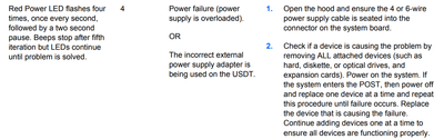

So, 4 month ago my PSU (DPS-600UB) died, no more fan spinning and 4 beep and 4 red lights.

In fact it seems to make the same error code as my previous failure : 4 beep and 4 red lights

 What i've find:
