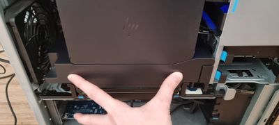

Also intake fan - on picture it should be Memory fan2
and
outtake fan - on picture CPU1 fan
and
outtake realr chassis fan
are all on high RPM and you can feel realy hot air from back of the computer (realr chassis) - all this make me think, that heat is taken from CPU correctly ...
Check the fan itself, and make sure that the air flow has no clog, and make sure that the second CPU tray is properly installed.
And do you use a GPU card?
V15MYassin
Check the fan itself - this is not easy task as everythink is boxed in plastic. What i see the intake fan is after the hard drives cages - but i didnt instal any 3,5 HDDs yet, so its as open as HP design allow - and both FANs are running ... you can see and hear it and also feel hot air flow on outtake site
GPU - i didnt instal GPU yet - just CPUs and RAM sticks
20240325_133043.jpg 20240325_133123.jpg20240325_133254.jpg20240325_133317.jpg
