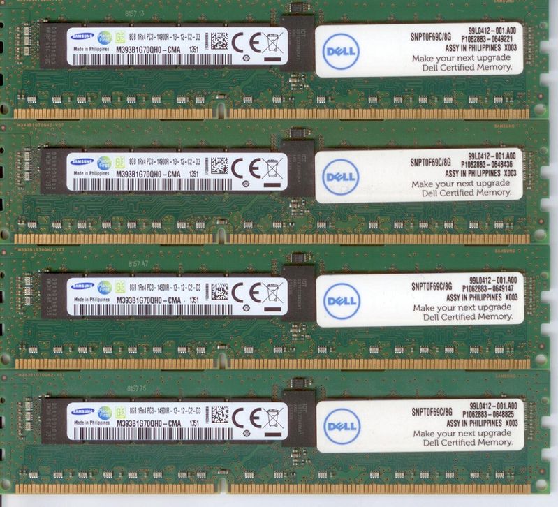

Note I settled on Samsung for the 8GB and Micron for the 16GB. The 8GB are single rank; the 16GB are dual rank. You can't mix ranks. Best/easiest to use same memory of same size and rank filling all sockets.
Regarding the memory... this is 1866 memory that worked great in our Z420 v2 and Z620 v2 workstations, and also worked in the old days in our Z600 v2 (but not the Z400 v2) workstations. Other OEM suppliers used these too, but I'm only showing you what I personally chose and tested by use over the years. We've moved on to at least the ZX40 HP workstations.
HP 731657-081 = 735303-001 Mic.jpgMine 16GB HP 712383-081.jpgMy eBay Micron HP 8 x 16GB.jpgSam Dell 1b eBay.jpgSam IBM 1.jpg

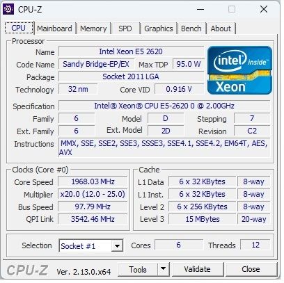

- I’ve downloaded the CPU-Z tool and attached is a screenshot with current values. I may be wrong, but it looks like the two E5-2620s on my workstation are v.0 (in other words v1) and not v2…right?
- I see the E5-620 supports SSE4.2 in the Instruction set … does this mean I can install Windows 24H2 on my Z620?
- Forgive my ignorance: I’m not entirely clear what QPI link means in term of performances … is that related to how much memory a CPU can support?

JC Z620 workstation - CPUzJC Z620 workstation - CPUz
