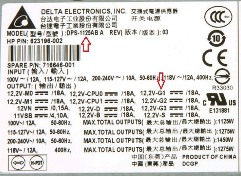

I believe you are underestimating significantly the power capabilities of your two supplemental power cables.
You can download the latest (v5) Z620 technical and service manual for slot capabilities from HERE , and also could look directly on the label on your Z620's power supply.... the ATX standard you are using is lower than what HP uses for the two 6-pin supplemental PCIe power cables in the Z620.  By quite a lot.  The exact rated amperage for those two HP cables were not in any manual I've found, but are available right there on the label.  I agree on the two PCIe x16 "video" slots providing 75W up to the card.  Other slots won't have that same power capacity.  Note the small writing on the label that total 12V DC is not to exceed 800W, and they tell you all the items to sum.  If you use SSDs instead of HDDs you free up some wattage towards the total, and same idea if you are using 1 instead of 2 processors.
Here's a quote from a past post:  "The Z620 power supply is easy to release and rotate out so you can see the amperage label on the top for the different cables.... those two auxiliary PCIe power cables the OP showed in his original picture are "G1" and "G2" both on the plug end and the power supply label.  Each of G1 and G2 are rated on the power supply specs label at 18A 12V.  That's a lot of watts worth of power available through each cable if you do the math."  To save you from digging into your case here is that Z620 power supply label:

HP has 6 pin to dual six pin adapters and also 6-to-8 pin adapters that are engineered to do what you need (see link below).  You're looking at those two cables as garden hoses when they could be thought of as two fire hoses.  There is a broad range of quality of adapters for the plug ends..... the HP ones will be engineered to the top level.
Look  HERE for added info, and there are a couple of added links in that one that will get you to more details.  We've posted in the forum here on the HP part number for at least the official 6-to-8 HP adapter.
https://h30434.www3.hp.com/t5/Business-PCs-Workstations-and-Point-of-Sale-Systems/really-only-1-6pin...

For some reason your photo was not attached: would love to see it and see this 18A. 216W on a single 6 pin is indeed amazing.
thank you for sharing so much knowledge!
Thanks for the detailed info SDH, my PSU label isn't exactly easy to access. I knew they could handle more than standard aux. PCI leads but not the specific amperage/power limits.
I did run my Z620 with a Quadro K4200 (108W) and M2090 (225W) previously and I only used one aux. PCI cable per card so effectively pulling 150W from a single aux. cable.
 Still, it's a little strange that HP recommends the total power of all graphics cards cannot exceed 300W. Talk about having a 'safety margin', (not a criticism of HP, maybe a bit over cautious?).

I do wonder on the other hand if there is indeed any magic sauce at all in their splitters or connectors. Right now I use Chinese-sourced 6-pin to 8-pin converters. I wonder if a standard 6 pin to dual 6 pin would work or would burn the workstation.
I think the magic sauce is in the PSU hand putting 18A in there. Afterwards it's just cabling. But maybe not 🙂 The only thing I could see is using a slightly thicker cable.

Happy to help.  This issue has been ongoing for years now, and I sure wish HP would put out a white paper on it, plus provide a HP quality easily found (1) 6-pin to two 6-pin and (2) 6 pin to 8 pin adapter.  I've never found the HP 6-pin to two 6-pin adapter part/option numbers, but here is the most recent version from HP (option number N1G35AA), and a source that has 3 available in stock for about 25.00 (!),  HERE.  The actual SP and AS HP part numbers have been posted in this forum in the past to help searching.
Regarding pictures in posts.... they'll only become visible when a moderator releases them.... check back in a bit.
Two added links, and this is still going on in the Z840s as you'll see.  I am sure those 6-pin cables are super-powered too.
HERE  and  HERE
Added in:  Below is a pic of the label from the Z840's 1125W power supply.... it appears to have 4 total PCIe supplemental power cables (G1-G4), all 18A too:
And, just for fun, below are the two power supplies for the Z820, one of which is the lower powered 850W version, and the other is the higher powered 1125W version.  You may know that the first has two PCIe supplemental 6-wire power cords, and the second has three.
You can see those in the two images below as G1/G2 and G1/G2/G3, all of which are 18A:
