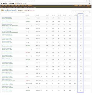

Perhaps you can glean some RAM performance from HP Z8 Fury G5 Workstation Desktop PC User benchmarks via UserBenchmark[dot]com:
Link: UserBenchmark: HP Z8 Fury G5 Workstation Desktop PC Compatible Components.
