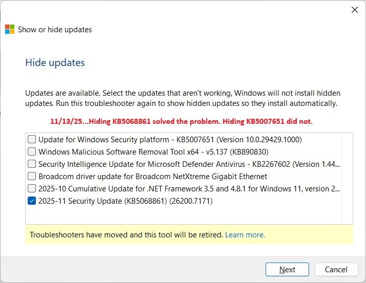

Made the breakthrough for clean install of W11 25H2 on ZX00 workstations, and it was painful. The process of elimination and tolerance for strange behavior by BIOS and the installers paid off. I'll post more details tomorrow, but the basics are as follows:
1. Microsoft has a bad security update, shown below, and the workaround is to "hide" that single one using the older MS utility wuhideshow.cab. That program can reach out to the Windows Update servers, see what updates are available for your workstation, and will let you choose 1 or more specific update(s) to hide before you run those updates so later when you actually do run Windows Update it cannot see the hidden ones. Added finding: It turns out that a "Security Update" can have more in it than what we'd think of as only security related.

Here's a couple of pictures showing the available updates via Windows Update as of today, plus show the one to hide. Don't forget to run Windows Update after you hide that single KB so you get all the others:

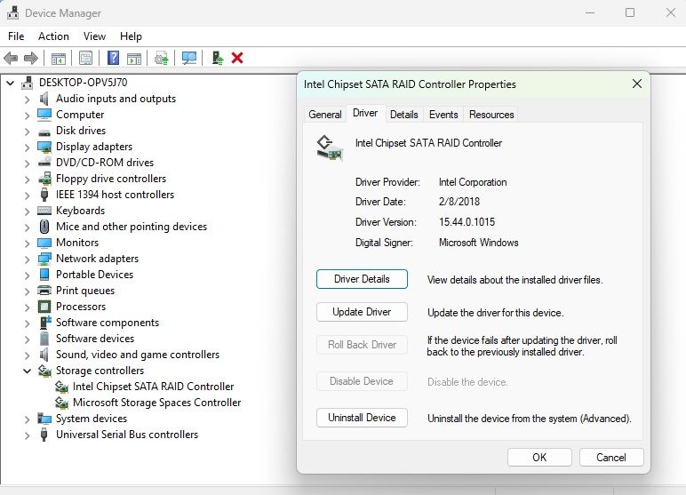

Here are the Storage Controller drivers from the W11 25H2 install while disconnected from the internet, and these remain after I reconnect and run Windows Update. I don't use RAID so I'm sticking with these rather than using the older RSTe (e = Enterprise) ones (which all the HP workstations are licensed for). EDIT: DGroves later in this post explains the difference.
