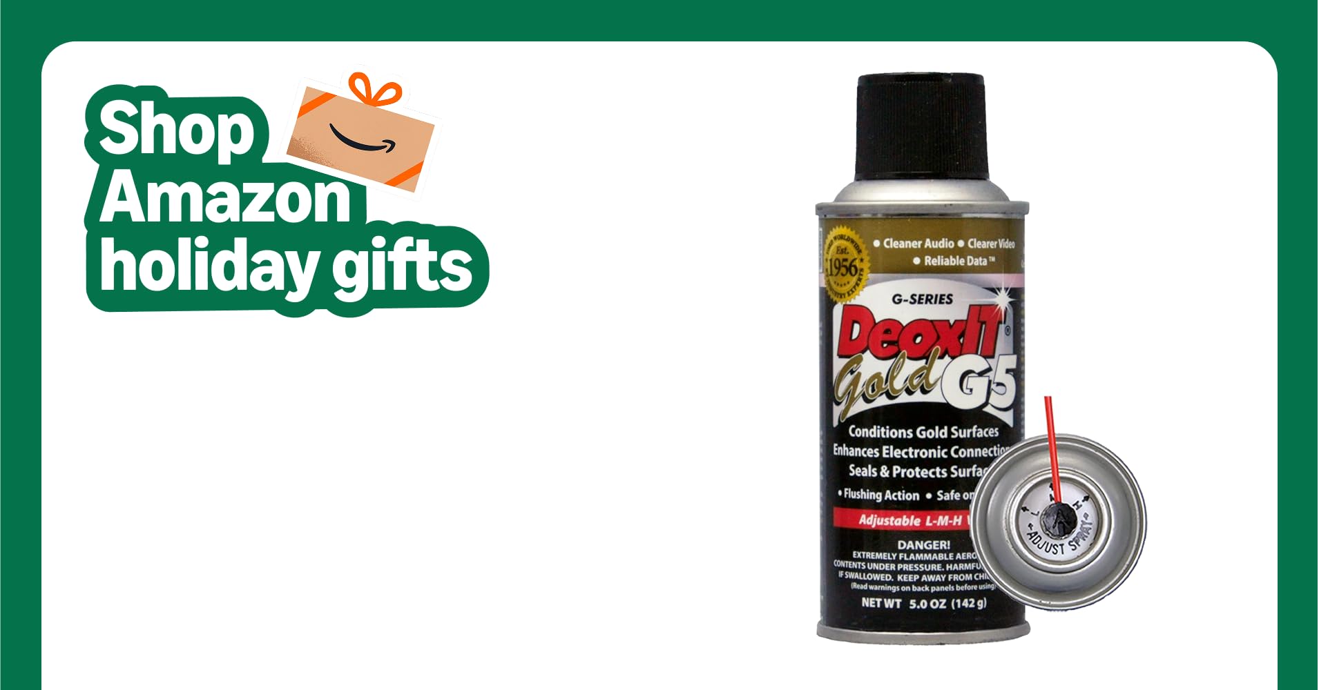

was the system sitting for a while? i had random memory issues with my z800 that were resolved by cleaning the dimm contacts and then doing the same for the motherboard slots
this product is not cheap, but it does work quite well in removing any contaminate film that can form on the memory/memory sockets over time
https://www.amazon.com/G5S-6-Enhancer-Protector-Surfaces-Integrated/dp/B003A7KHK8
ps, it also works on the cpu pads and you can also simply spray the cleaner on the cpu socket pins (don't touch the pins with anything like a swab!! just use the spray from the bottle approx. 4/6 in away from the socket pins)to coat the pins

No, the system was running all the time. I cleaned RAM contacts, but that didn't seem to change much. I'll try cleaning CPU pads though, and maybe will swap sockets to see if maybe one CPU has issues with memory.
general purpose cleaners will not work on the dimm/cpu contacts you need a cleaner made specifically for this
