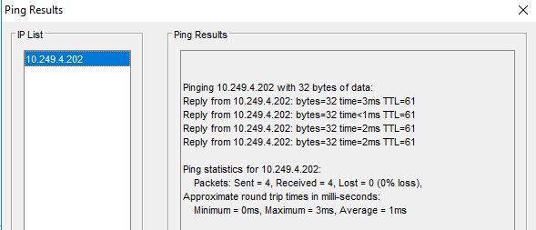

I can ping them from my server.

It is possible to ping each other on IP and on Name.
Both machines are on a different network.
