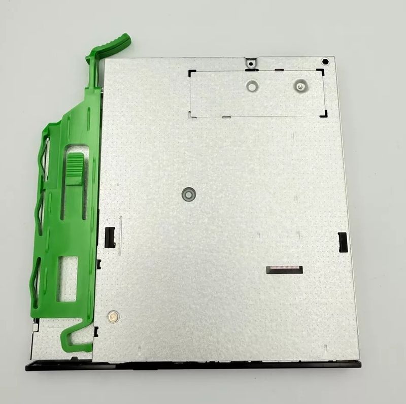

Well, that is poor service indeed, but you may have created the situation. Attached below is an English version of the HP QuickSpecs for this computer, from 9/24, for reference. Perhaps you can find a Hungarian version? I assume it is a Tower computer... sometimes there are multiple form factors.
A good way to start is to look at YouTube. Even if you can't understand the language the videos can be very valuable. Try:
https://youtu.be/Dng1WNAh2S4 This is from HP and at 14 seconds in it shows the topics. Optical drive starts at 50 seconds in. Hard drive cage info starts at 3:33 in.
Another is  https://youtu.be/XX26pY6FXME
Your mistake may have been to order the computer without the optical and two HDDs installed to save some money. There can be specially made HP mounting parts for both the 3.5" hard drives and the optical drive that can be very hard to find when the computer is newer, like yours. Later odd parts become easier to find when the retired computers get parted out. Your HDD mounting cage does not appear to have the narrow horizontal cutouts that I'm familiar with. Below is a picture of the type of 3.5" HDD metal/rubber sliders HP has used in the past to fit in narrow cutouts.... those for a HDD use an imperial #6 screw. 2.5" HDDs and SSDs use M3 metric screws instead (with black rubber cushions instead of blue).
I think you may also need the green HP plastic part shown in the two added pictures that clips into the optical bay slot inside... look at the HP video.
Bottom viewBottom viewTop viewTop view
Good luck on your project...
HP sliders for 3.5" HDDsHP sliders for 3.5" HDDs
