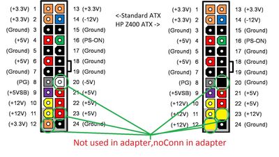

04-30-2021 02:24 PM
DGroves,
Actually there are 3 pins different for ATX and z400 power supply pinout and those pins aren't used in this adapter.
I have this adapter and checked it pins.
Please see the picture.If I mistaken let me know.
