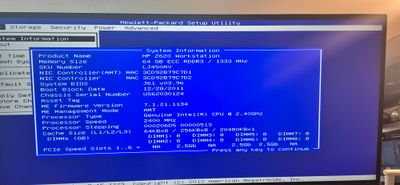

Hello. Currently I have hp z620 with xeon e5 2665 cpu. I am using it for plex server but its performance is not enough for 1080p HW video with subtitles transcoding. Thinking about upgrade to dual cpu. Which one will be best? I have 2011 boot block date, so 2690 V1? Also i found some cpu risers for z620 online, are they the same or is there any compatibility list?
I am also getting "incorrect microcode detected, contact HP" when booting up, but it will boot normally.

My recommendation is to move up. Yes, that is a Z620 v1. The v2 has a 2013 boot block date. You could consider upgrading to a v2 motherboard, and how to recognize one of those on eBay has been posted about here in the past. The "riser" addition to the motherboard if you want to run two processors is the same regardless of whether the Z620 is a v1 or a v2. That riser is different from the one used in a Z640 dual processor workstation despite looking very similar.
