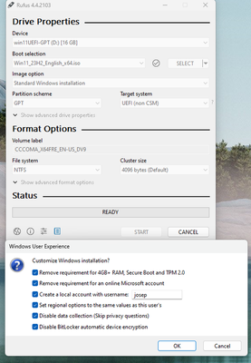

For a new system that has UEFI bios and GPT but does not meet all requirements,
Windows 11 can be installed using the Rufus trick.
Get Rufus here
Download Windows 11 with this link and use an 8gb or larger USB.
Windows 11 does not expire and Microsoft just leaves an activation reminder on the screen.
Otherwise use the windows 10 license.
Configure Rufus to use UEFI boot and select the option that creates a local account
so as to avoid the Microsoft email login. Use options shown below:
Uncheck the "Set regional options" if you are creating the USB on another system that has a different OS than yours.
Do not install 11 Pro if you are licensed for 10 Home.
To do a clean install then boot the USB
You have to click "start" before those options show up.
