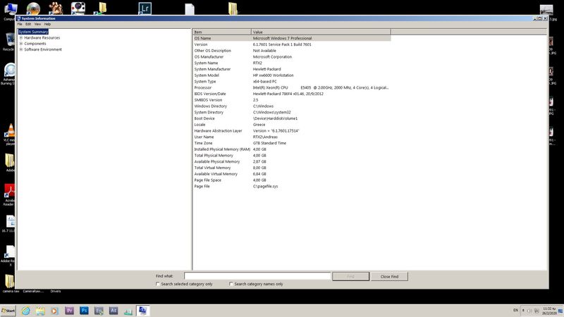

after msinfo32 in Windows 7 Pro
for Graphics card getting:
Needed install/Upgrade driver for NVIDIA card????

Can you tell if there is BIOS Update for this msinfo32 PC:   // ????
Needed update this driver of NVIDIA GTX 260 Card????  Still Windows 7 Pro
Can Update from Device Manager?

HP xw6600 Workstation System BIOS 01.46 Rev. A 3.1 MB Oct 16, 2012
is the same as 01.46 Not with Rev.A???
Is BIOS needed update, for below replied screenshot?
Is this important for upgrade from Windows 7 to 10?
