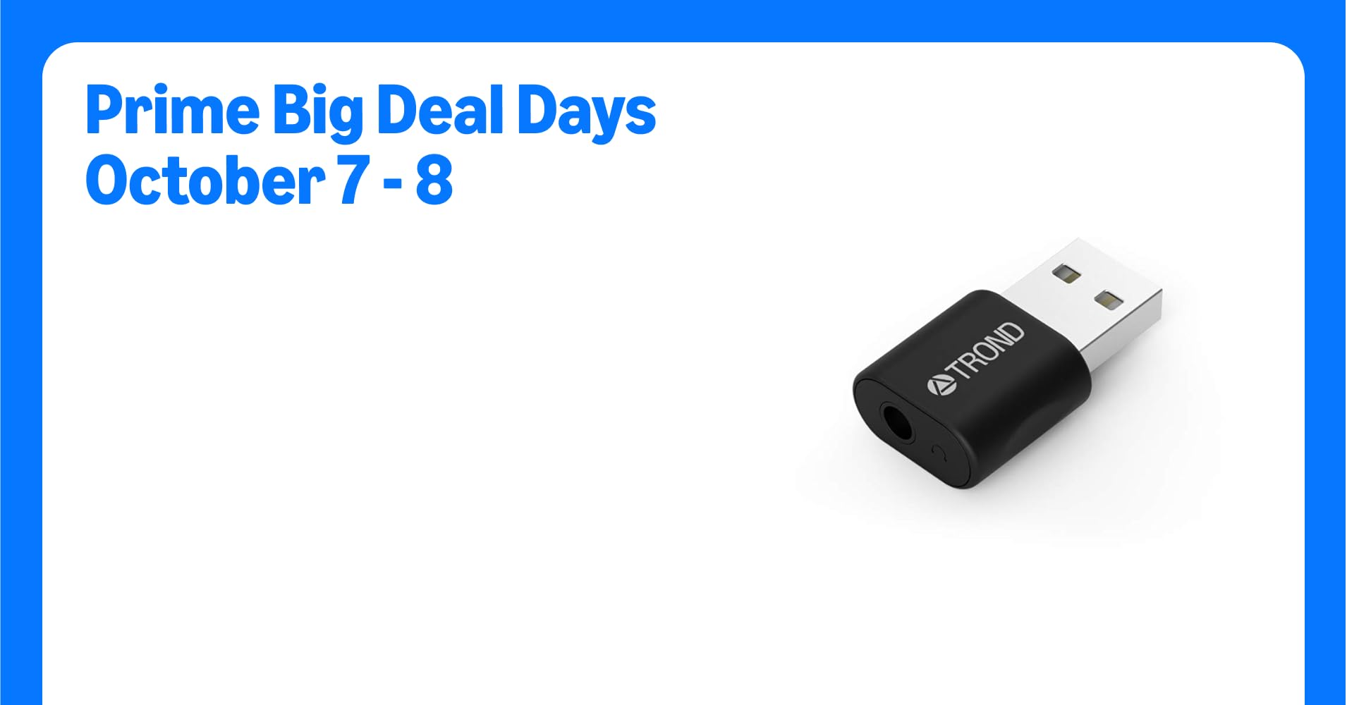

Audio seems to be a hit or miss with external speaker. Front jack no success but rear jack works intermittently. Will look into later. And I will look into USB to 3.5mm adapter.

One USB to 3.5mm adapter example is something like this: https://www.amazon.com/TROND-External-Adapter-Integrated-Microphone/dp/B07L56C28R/ref=sr_1_66?crid=R.... The advantage of an adapter such as this one is that it supports full headphone (+ microphone) functions.

Thanks. I'll look into the sound card adapter.
