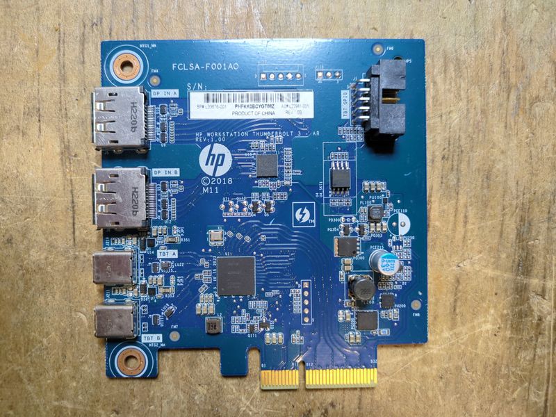

I'm working with a Z8 G4 and an HP Thunderbolt 3 card but it's missing the GPIO cable. I understand that the part number is
L27677-001
But I'm unable to find a place to purchase this cable.
Is this available from HP or another reseller?

hp does not sell the TBolt cables as separate items only with the card
however most TBolt cards are based on the intel reference design and have the exact same header pinouts all of the HP TBolt 2/3 cards i have seen are based on the intel reference board but i've obviously not seen them all
this previous posts has picts of the cable ends
https://h30434.www3.hp.com/t5/Business-PCs-Workstations-and-Point-of-Sale-Systems/hp-Thunderbolt3-Ca...
the issue arises on the motherboards' most TBolt 3 motherboard headers are 5 pin but can be wired differently
it should not be that hard to use a multimeter on the MB and determine the gnd/power pins leaving only the two data lines which if wrong will not cause damage just swap if wrong this allows you to use a dell or lenovo TBolt cable for example
last check your systems "service manual" for some systems the MB TBolt header pinout is documented
note one pin is missing on the MB 5 pin header used to key the proper insertion

The Z4, 6, 8 G4 workstations all use the same TB3 kit based on their respective HP QuickSpecs so the TB3 GPIO cable will be the same for all 3.
He and I worked on some TB3 GPIO pinout stuff on the post HERE and my scribbles and pics are on that page. So far TB3 has been a time sink with little reward.

EDIT: The HP GPIO cable does feed power into the HP TB3 card but the HP GPIO cable for the HP TB3 card is much more complex as shown in the link I provided above. I'm quite sure that cable even if it is for a Lenovo TB3 card would not work for the HP card. Looks like you may need to make your own.

What you just posted is one of the cables that IIRC HP had for their original TB1 PCIe card built for the ZX20 generation of HP workstations. As DGroves has posted here that first generation of HP TB PCIe card/GPIO cables was a Frankensteinean creature using traces on the motherboards that were never originally intended by HP to be used for Thunderbolt. As such there were 3 separate GPIO cables for use with different HP workstations. There then was a different GPIO cable for the ZX40's TB2 PCIe card, and yet another for the ZX G4 generation's TB3 card, and now comes the ZX G5's TB4 card (which uses a 2x6 plug at each end with one blank each end of its GPIO cable and now a total of 11 wires). Hence much confusion.

I certainly don't mind making one if I know the pinout and which are the correct connectors. I wish I had some part numbers for the connectors.
It seems so strange that HP doesn't have a solution for this. The Z8 G4 was still in production rather recently. I have to think there are lots of machines out there with these cards that are still under warranty.
I might just go through some boxes of misc computer cables and see what fits. Something with the right pin spacing, even if it's not the "correct" connector might suffice.
BTW, here's the card that I have.
I gave you that already,  HERE .
Down near the bottom, fluorescent green post it notes.... can't miss them.
Try mouser.com. 2x5 plugs. You can slurp in a bit of epoxy to the one blank hole for each plug end if you wish. You won't need to have the clip for retention at the card end.... friction from 9 pins will be enough.
