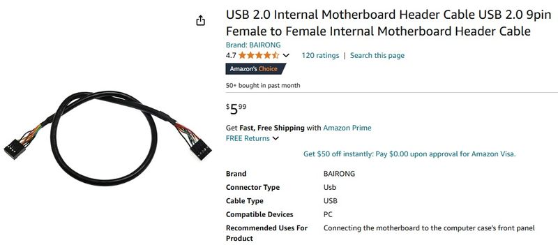

You may have noted that some of the cards shown on eBay if you search via that number have a cable attached to a lower smaller header on the card rear... that is a C-Link cable of no value to you. You need a cable that attaches to the bigger upper USB2 header on the card rear... again only if you want to use Bluetooth in addition to WiFi.
Your motherboard has that two-channel USB2 header... the Bluetooth capability only needs one channel to work. That motherboard header type is very common, called a 2x5 with one blank USB2 header. The same type of header is built into the top rear edge of the HP WiFi/BT PCIe card. Here is a source for a quality cable that is plug and play for your motherboard, from Amazon:  https://www.amazon.com/BAIRONG-Internal-Motherboard-Header-Female/dp/B097GHT5N4
This will work for you...This will work for you...
