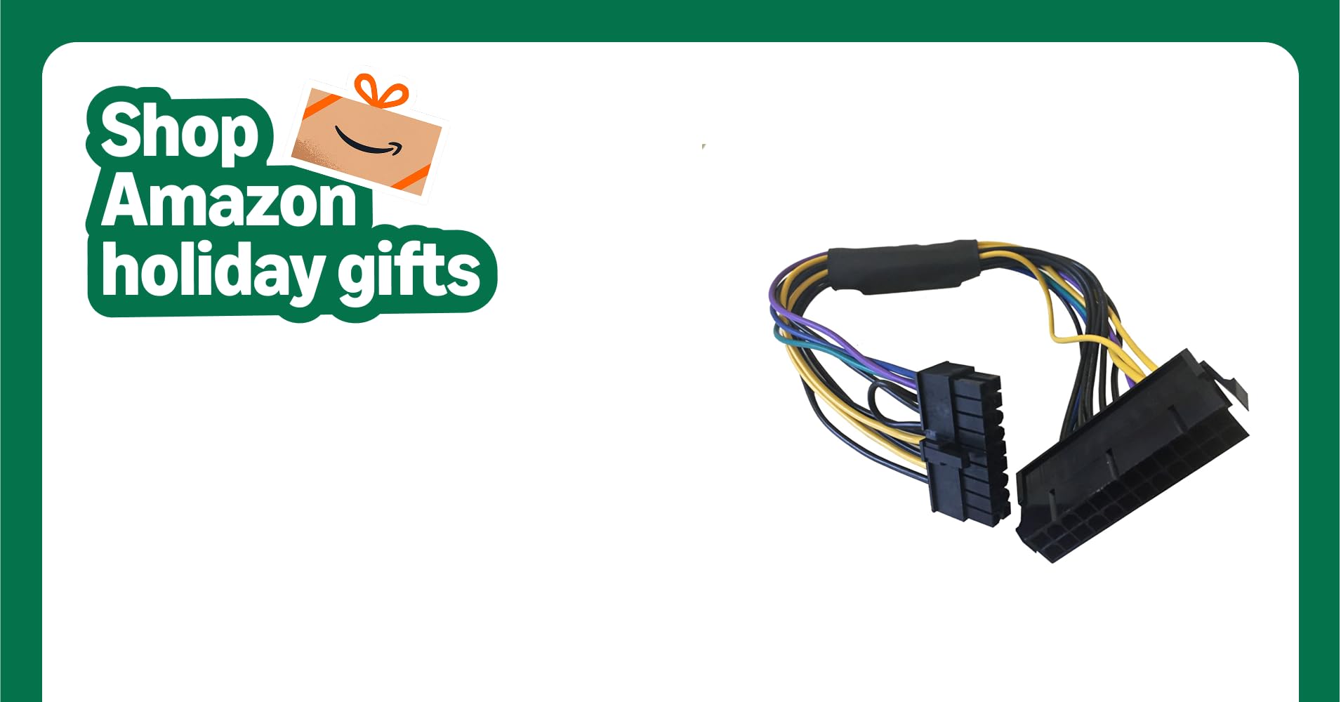

HELLO SIR, I NEED FOR HELP ABOUT CHANGE MY POWER SUPPLY FOR MY PC Z220 BUT I HAVE PSU ATX 18 PIN AT MOTHERBOARD, ALTHOUGH I HAVE ANOTHER POWER SUPPLY PSU ATX 24 PIN.                                                                                    NOW, WAHT SHOULD I DO?
CAN I USE  PSU ATX 24Pin to 18Pin Adapter Converter Power Cable Cord?                                                                                                                  IS MY PC Z220 SUPPORT THIS CONVERTER POWER?  THERE IS (https://www.aliexpress.com/item/PSU-ATX-24Pin-to-18Pin-Adapter-Converter-Power-Cable-Cord-for-HP-Z42...                                                                          PLZ, I NEED YOUR HELP AND ANSWER ALL QUESTION  BECAUSE  I AM WORRY ABOUT MY PC FROM HARMFULL.                                          THANKS, TO READ ALL MY PROBLEM AND I HOPE ANSWER TO ME TO FIND AWAY FOR THIS.                                                                                                                                                                                 THIS IS CONVERTERTHIS IS CONVERTER

I would look at the service manuals for both systems as they each have a power supply pinout.
compare both and you will quickly see that the z220 has a custom 6 pin motherboard header
https://www.amazon.com/24-Pin-6-Pin-Power-Adapter-Workstation/dp/B01NAHMULC

if you have a 18 pin connector, you do not have a z220 motherboard, they all use the 6pin pwr connector
you might possibly have a z230 board, however you need to determine this before you proceed.
can you post several pictures of the board and list the HP part numbers off the board
if you do have the z230 then this adapter is needed
https://www.amazon.com/11-inch-24-Pin-18-Pin-Adapter-Workstation/dp/B071NL4VK2

again, take the time to download the service manuals for the z220 and z420 COMPARE the power supply pinouts between the two and if they match you will have your answer also i see what appears to be a white 4 pin connector for CPU power if this is so does your ATX supply have a 4pin CPU aux connector? (some do some don't) and based on what i've seen the adapters for the z420/620 WILL NOT WORK ON THE z220
based on the above i strongly recomend you simply buy a z220 power supply

I'd be careful when doing this.
Just because you have an adapter to go from 18 pin to 24 pin does not always mean it will work.
Our workstations do not always follow the standard pinouts.
Workstations are not designed to have their PSU's upgraded and are only designed to use the PSU's made for it.
