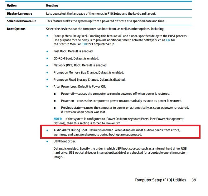

Do the same thing the old type of BIOS allowed with your much newer BIOS... I may have found the BIOS setting for that in the Z4 G4 technical manual which I believe will also allow you to bypass your recoverable error issue in your Z4 G5. Please try it and let us know if this works for you. This option should result automatically in the equivalent of you physically pushing the F1 button each time:
