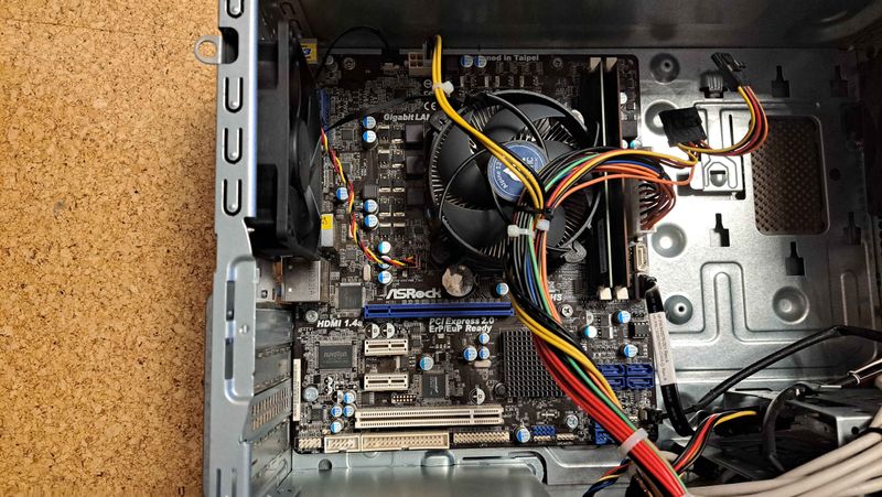

Hi,
After all the hassle and attempts to update the BIOS, I finally solved the issue — by buying a non-HP motherboard instead.
Thanks for the "support".

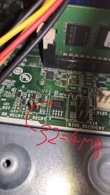

I would also like to add that BIOS version 8.06 is 8MB, but my PC has a 4MB BIOS chip. Trying to flash an 8MB BIOS to a 4MB chip would cause a brick.
I’m also having an issue with AFUDOS, specifically with the BIOS being locked (more details in the photo).
